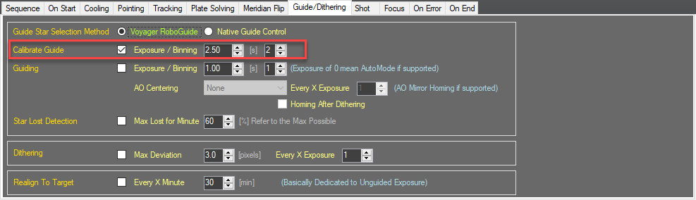

I would suggest to also look at the Exposure length and Binning settings in the Voyager Sequence definition, Guiding panel. These are the values that will be used for Calibration when started from Voyager - make sure they are high enough to get a good star for calibration in PHD2. OAG’s can be especially tricky to find a good calibration star.
