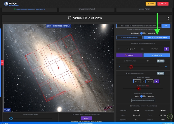

Hi Eothrin,
you need to check your camera Position Angle. This is a tipical issue when you start to design a mosaic without get the correct camera orientation. I suggest to retreive it automatically from webdashboard with a plate solve. This can be useful if you don’t have an observatory (movable setup), so every time you can check the actual PA. In case you have a stable setup in observatory you can set in Voyager the actual PA and this will be sent to WebDashboard at connection.
Here a screenshot for direct plate solving from Virtual FoV in WebDashboard, and Voyager settings for fixed position.
I repeat, is indispensable to set correctly PA in VirtualFoV before design a mosaic or plan a frame.
It could be a good practice to mark, also with a little sign, the camera orientation on your connection or focuser, so you can reproduce every time the same alignment.
Of course If you have a camera rotator you can set every time your preferred orientation.
For any further clarification do not hesitate to ask other.
