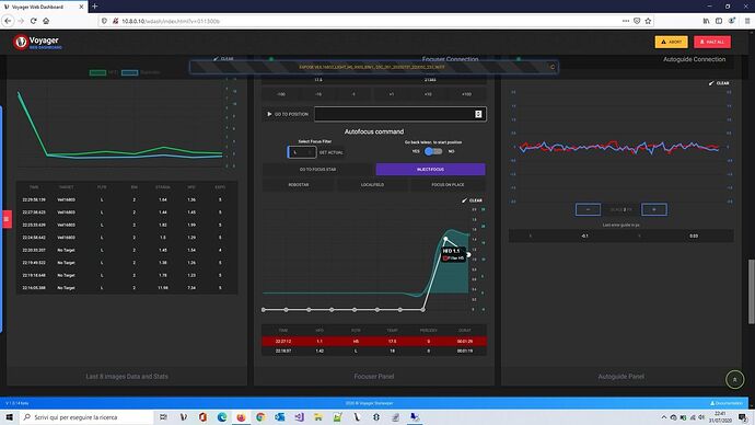

What wrote from @yzhzhang is the right way to do this task, in an automation software it’s really essential to remove all manual tasks if really doesn’t need:
An example of select a taget on Virtual FoV with stretch and shot on the sky:
