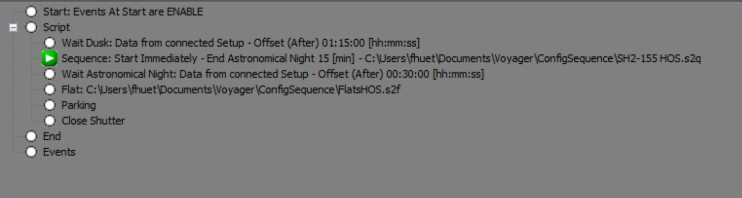

I am just trying a script tonight (my first script):
  • Take images during the whole night.
  • Take Dawn flats
  • Park Skope
  • Close Shutter (close roof)
I hope it will work!
Fernando
The Wait Astronomical nights before Flat is not needed, Dawn flat wait automatically for Dawn.
