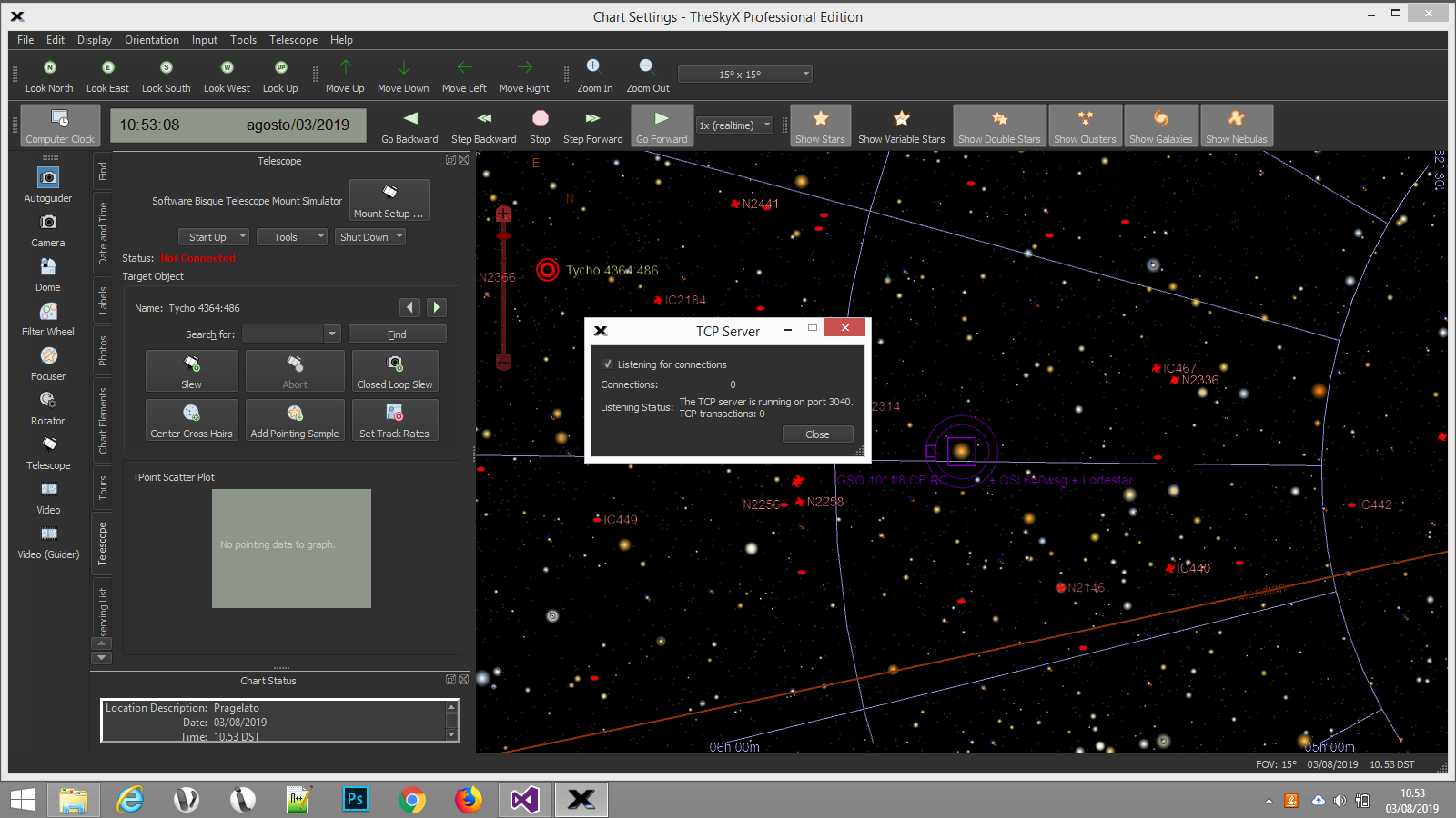

Make sure you run SkyX as administrator at least once before connecting Voyager
Welcome Rajeev and Mike … thanks Mikefor answer:
TSX talk with other application using a TCP/IP server, to register it you need to start at least once as administrator also you need to leave checked forever the TCP Server listener like in image. You’ll found this under Tools menù.
Mike, Leo,
Thank you - that worked!
