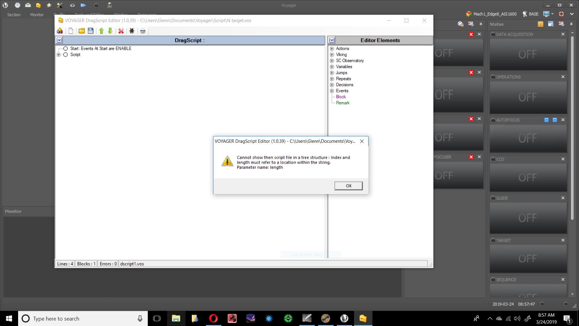

I am encountering an error when trying to load a DragScript that uses a variable counter.

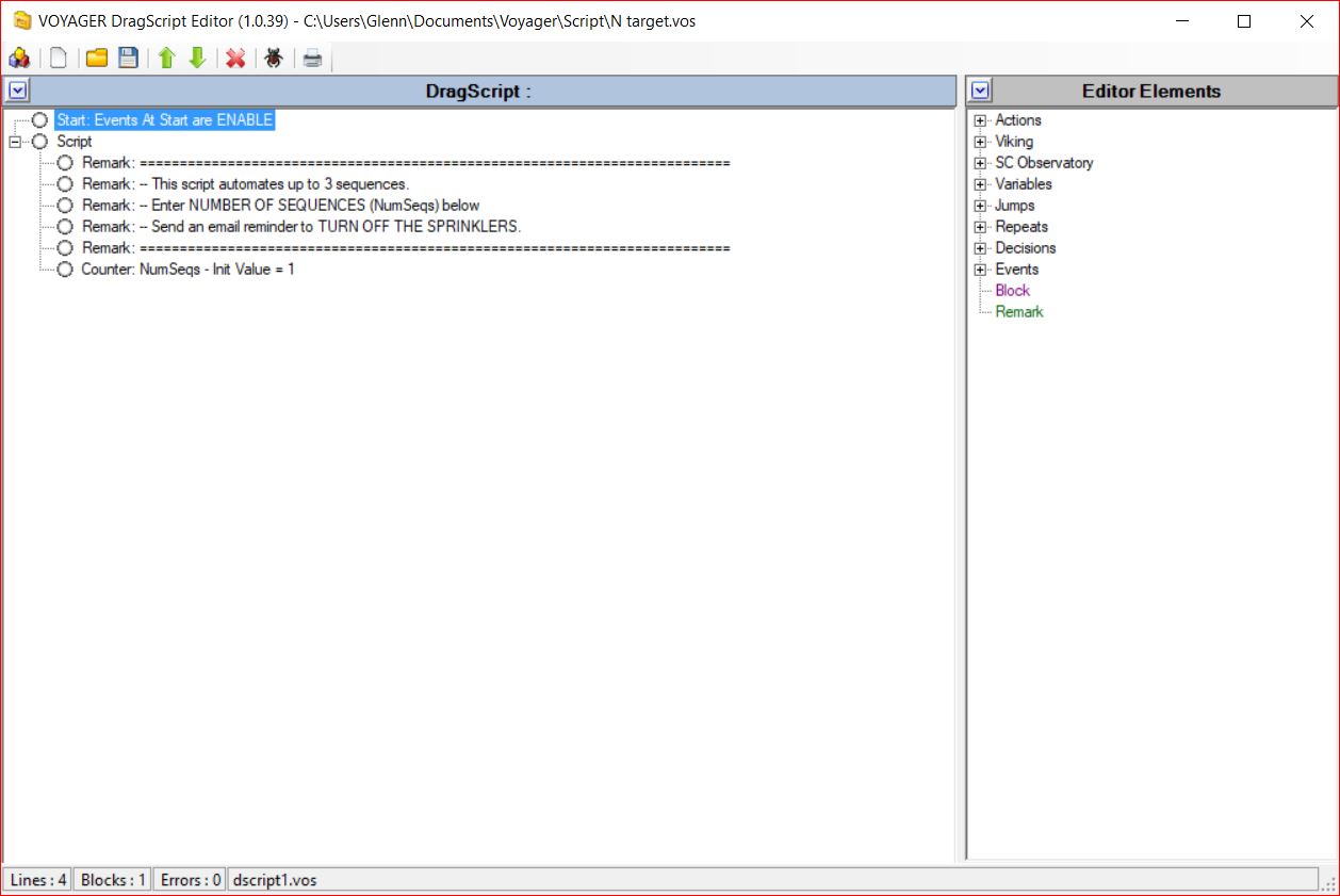

And this is what is actually loaded by the editor. It seems to stop when the variable is declared.
Here is an example script that will not open properly.
N target troubleshoot.vos (153.0 KB)
Best,
I don’t modify editor … I just change simulator. Are you sure your file is not damaged ?
I now have several scripts that will not open in the editor of this daily build. I was just reviewing some of these scripts in the previous daily build before updating and did not have any issues. It is unlikely that multiple drags script files became corrupted simultaneously, but who knows? I will try to roll back to the last daily build and see if the problem goes away.
If all throw error is a daily build problem
All of my scripts open properly in version 2.1.1a, Leo.
Best,
ok thanks … i used this night without problems… now i check your file
I found problem, was in the pretext from mail block … i use 80 char but there’s a bug if is shorter.
