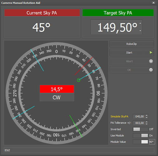

NEW => Tools → Added optional module 180°/90° to camera manual rotation Aid tool. This allow to use module angle of requested closest to actual rotation if you dont care of vertical and/or horizontal flip (Cyano line is the module angles, green circle is the closest angle to reach used like reference)
To avoid problem on understanding inverted mode i changed the graphic of graduated scale, now is double, internal is for inverted, external for normal. I also add a circle icon to aid on understand.
An example of same angle and offset in normal mode:
I downloaded and used this version last night, this is a great addition and very easy to use to set rotation. It took about two minutes to dial in to a new PA within 1 degree.
