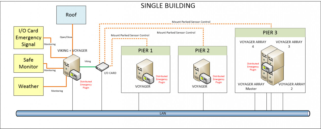

I have basically the same setup as @Wayne1 … 2 piers and a 3rd computer getting set up for Distributed Emergency right now … My primary concern is that I have an interference issue with my big refractor and the roll off roof. @KGoodwin … In your response, you say that the Master sets the status to safe once the roof is open. Is that for sure or do I need to script around that? The roof controller wont let the roof move unless the big refractor is parked (it has it’s own safety devices) but there is nothing within Voyager or the plugin documentation that doesn’t allow the mount to move if the roof is closed. Similarly, I need the big refractor to be parked before I even ask the roof to close but thats all scripted in right now as that instance of Voyager controls that mount and the roof. Probably worried about nothing and Leo has it all thought through but thats just my modus operandi. Thoughts?
Given that you should implement sensors to detect whether the roof is open, closed (and it’s not the dual of the previous one), and whether the mount is parked (all mounts), you can see the plugin diagram. However, if you want to disable the goto if the roof is closed, you’ll need to use Viking and a digital input:
https://wiki.starkeeper.it/index.php/Viking_Setup#Viking_Setup_Workspace
This is because Voyager absolutely doesn’t rely on the driver status for these operations and relies solely on electronics and direct readings.
Thanks for the quick response … My roof controller (Dragonlair/ASCOM) does report the condition of the roof: Open/Closed/Moving to Voyager via it’s own physical limit switches. Is that sufficient or is that what you mean by “Driver Status”?
I already have a Denkovi relay with 6 more inputs available, so it’s not an issue to get some reed switches.
No it is considered an ASCOM driver if it is not connected to Viking
