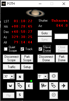

Heres what I see in that box when I have POTH running and slaved with my scope:
I have been running a NexDome from Voyager since April using the now discontinued “Official NexDome” driver.
I used POTH initially because it provides access to the NexDome driver setup dialog. This configuration worked well enough to allow me to develope and run an Image_All_Night script, but it suffered from occasional disconnections from the dome driver.
Since switching to the ASCOM Dome Hub, I have not had a disconnection incident. The switch was easy, I transferred all the POTH settings (in mm) directly into ADH without converting to inches.
The only impact on my script was the need to add Dome Sync OFF elements before every Dome Find Home command because the ADH does not automatically unsync, while POTH does.
I still run POTH when Voyager is not connected if I want to access to the NexDome setup dialog to read the shutter voltage or see the status of the rain relay.
