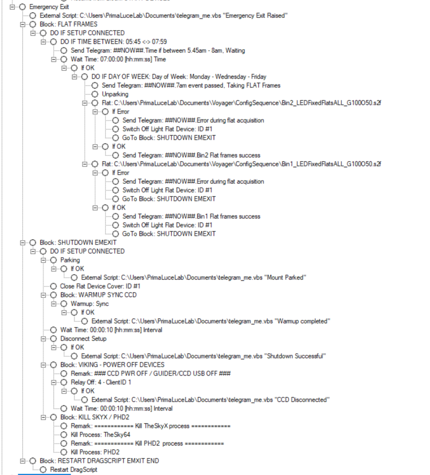

I use it in the Emergency Exit routine, and so far it’s been working rather well.
Before proceeding to shutdown I check we are within a time when the roof is closed in the morning, wait for the time I want to start and when to take flats.
This is done with Ascom controlled remote powered flat panel. I could deal with error handling better, and I’m sure there are other ways to do this , but this way works for me.

This is very similar to what I’ve put together. I’ll give this a try. It must be something that I have been doing incorrectly as my dragscript tries to launch the AutoFlat script and fails. Using your script will hopefully point out for me where I’ve gone astray.

Thanks all. User error as expected. Danj, I lookled at your dragscript which was almost identical to mine with the exception that I created a folder under ConfigSequence for my new filter flats. For some reason the new folder wasn’t a problem when running AutoFlat in OntheFly but Dragscript didn’t like it. As soon as I copied my new Autoflat DragScript from the folder and put it in with the other ConFigSequence files it works perfectly.
