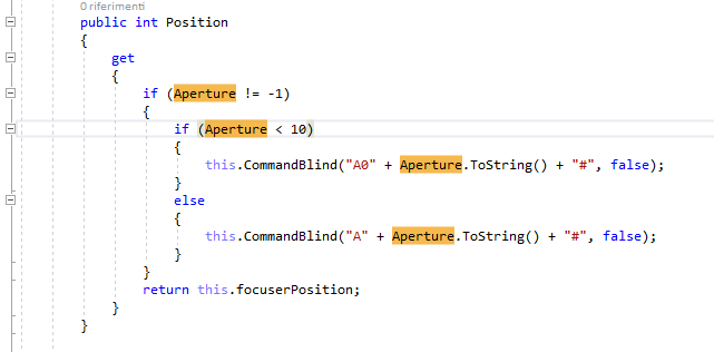

I’ve done some reverse engineering:
immagine
Aperture is only a variable to define the command string blind during position request !!
Cannot be changed externally.
