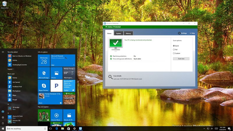

The error message you have indicated occurs because your PC blocks communication between programs. Add the programs you use to the exceptions of windows defender and antivirus. In general, I recommend that when you get to a configuration that works you do not run more updates, especially if you travel for do imaging (not your case i see dome setting up).

If you have win10 … disable Defender is an option to evaluate. Because window switch on Defender without ask to user.
“PHD2 is busy” is a courtesy error message from Voyager when a command from Voyager was not executed by PHD2 and go in timeout. This mean Defender or antivirus are blocking tcp-ip connection, inspecting packet in tcp-ip connection, guide camera is freezed , phd2 is freezed and if you not use ST4 (and i recommend to use it) and use mount … mount driver is blocked or phd2 freezed waiting mount driver. Voyager doesn’t need mount connected to PHD2 also a lot of mount driver doesn’t allow more than one connection.
If you add exception in defender for file, dir, process you are sure to prevent OS side problem with reasonable success.
Also you can postpone the update since to 180 days in win10, if you do update scheduled you could avoid this update problem. The best is to use previous OS for observatory PC.
