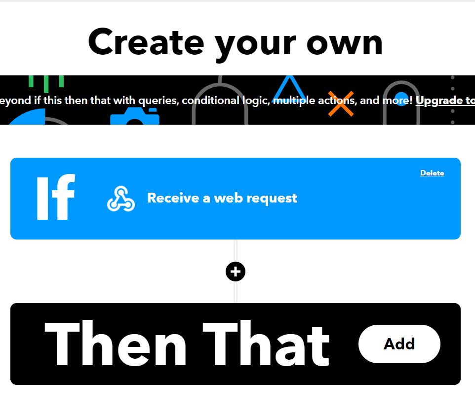

Click on ADD, search for Webhook and select it:
Write your Event Name. Please take note of the event name: You have to use it later in the script to invoke the webhook. Create the Trigger.
Click now on “Then That (Add)”:
Search for Smart Life service and select it. Please, note you cannot use, as action, “Devices” in IFTTT/smartlife service, but only “Activate Scene”. Select it, and from drop down menu select your “Scene” previously created in SmartLife app. “Create” your Action.
