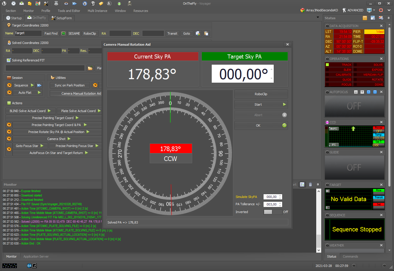

With the great new framing and Roboclip feature in Dashboard, it would be useful to have a “manual rotator” feature that does a plate solve and not only centers the target but pauses and tells you how much and which direction to turn your camera. I suspect this goes against the all automated capabilities, and I suspect I can figure it out with a little practice, just throwing it out for consideration.

Dear Wayne, a manual rotator in a automation is not necessary. If you want to rotate the camera assisted use the plate solving actual position in onthefly , read the PA and rotate camera until you reach your desiderata.

Wayne, you can get your PA by plate solving and set it in Voyager > Settings > Camera P.A. to get it automatically on Virtual FoV every time you connect, or use the dedicated button “Solve Telescope position and PA” to execute and get in one click telescope position and camera P.A. in Virtual FoV at the moment.
You can also change manually the VirtualFoV P.A. with slider, it will be stored in RoboClip with other target data and showed in visualization when load it again.

actually having a manual rotator is a HUGE benefit - when running a sequence during the plate solve if manual rotation is set in rotators it should tell you how far off the rotation is - its a simple task to then go to my manual set up and rotate it - get it to plate solve again until rotation is less than the max error selected in the settings - not every one has an automated rotator and many who do not still use automated sequences - it plate solves already so just show the difference in angle and direction to rotate - this would be a huge help

I will add a little DragScript to do this with a user prompt in the next coming Daily Build.

I appreciate any developmemt on this. I have been reading the PA in the console window. Just I find it so hard to read. Especially running back and forth. Remembering which way to turn has become a game.
I would be happy with a window that showed me last PA in a large font but thats just a quick solution. I will wait for whatever you decide.

Finished, I will pubblish the daily build with the new Tools in few hours:
