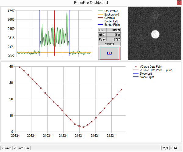

There was a moment of clear sky tonight.
After increasing the max flux to 5000 and setting the star magnitude for LUM at 6-7 and letting Voyager select a star, I was able to create a 1st V-curve. Still saturated, but the curve developed ok this time.
Thereafter did a few focus runs on a star and a field. Both were successful.
