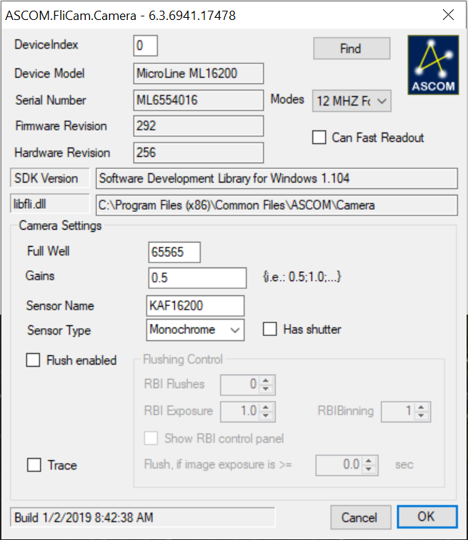

The ASCOM driver, last I tested it, did not set readout mode correctly at all times. Sometimes it would, and others it would just take images in focus mode readout, which are not any good.

Problem found, there is a checkbox in his driver labelled “Can Fast Readout” if you have this checked, the mode will not change, even if Voyager sends 2Mhz. With it unchecked the camera works just fine.
Looks like I may be able to remove SkyX entirely now.
