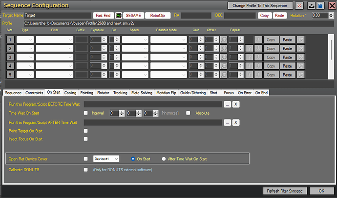

Hi guys im trying to start an advanced session but the mount will not slew im not sure what im doing wrong
OK, one thing at a time. I can see you are using Advanced. You need to go in to the base sequence you have set up and in the “On start” tab tick the “Point target on start” otherwise Voyager assumes you have already centred your target.
The second I would look at is the plate solving. In the plate solve tab in your second screenshot, have you configured the solver you are using there? And tested it against the sky?
Then on to carrying out a V curve, do you mean to set up focus or to actually focus during imaging? Before using focus you need to have the scope in reasonably good focus, preferably plate solving working and a plate solve and sync carried out. After that, click on the “Point closest focus star with Robo Star” button and wait for that action to finish, then run the first light wizard (For the first light wizard, don’t try to pick out and center a star yourself, use the "Point closest focus star button)
If you have already successfully run the first light wizard and you mean it is not focusing during imaging, have you set the base sequence to have Voyager manage focus? If you have not, it will not.
It does not look like you have meridian flips set up either, but one thing at a time as I wrote to start, so long as your mount is set up to stop tracking at the meridian or at least before a pier crash will happen.

So last night i managed to image but only after i pressed the go to target and centre. So as you mentioned that should be resolved by ticking point to target in my base sequence

I thought I would put this in a separate post.
For the automated flips, you need to set it up both within the mount setup tab (The “Do flip after passing meridian by” checkbox) and you need to work out a time to put in there in minutes which is the minimum time after the meridian that Voyager will carry out the flip (Some mounts like one of mine are fussy about syncs near the meridian and the plate solver after the flip MUST be west of the meridian or the sync will be rejected and re-centering fails, the flip time needs to be far enough past the meridian to be positive that the post flip plate solve will be west)
After that in the sequence you need to select “Manage” on the meridian flip tab, I normally select for it to inject a focus run after the flip, and you should tick the “Force meridian flip…” checkbox and enter a time which will have Voyager force the flip (And abort any running exposure) before you have a pier crash.
Ideally, the flip time in the mount setup will make sure if you have a mount like mine that the re-center wont fail for a rejected sync, and the “Force meridian flip” time will allow any running exposure to complete without allowing a crash. The critical thing being avoiding a pier crash! If the longest subs you shoot were 600 seconds for instance and your gear will go half an hour past the meridian without a crash, you can set the flip time to ten minutes, and the abort time to 21 so even if a 600 second sub started right before the ten minute mark, it will finish and THEN the mount would flip.
