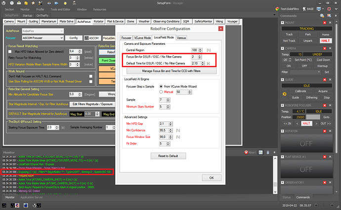

I’m having a little different problem. I have an ASI294 OSC. It starts Local Field fine, but I get an “Empty IMage” message after a while. I’m using the TSX Camera Add on and get the same problem with both the X2 drivers and the ASCOM drivers.
Action Aborted for Error : Focus Async Error (Error executing LocalField VCurve AutoFocus : Something goes wrong, memory RawImage is empty)

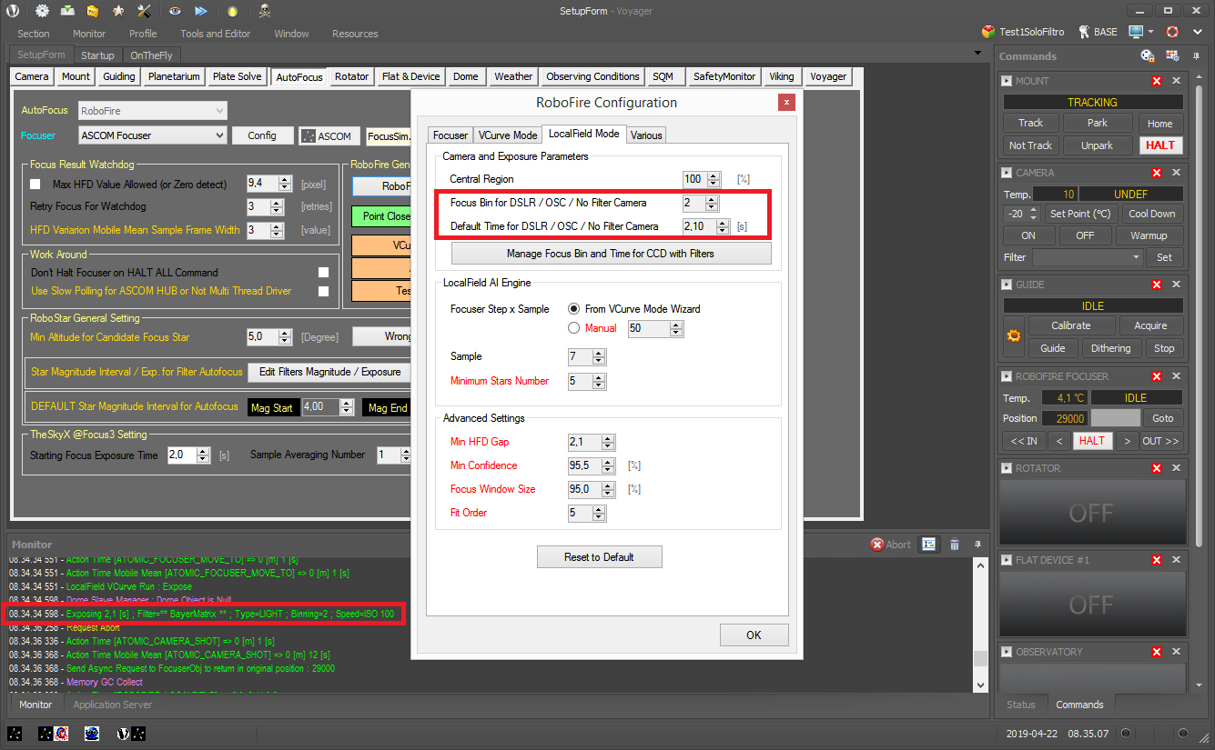

I can’t seem to set the binning to 2, during the process it always shows bin = 1. I’ll check out the ASI site to make sure I have current drivers
