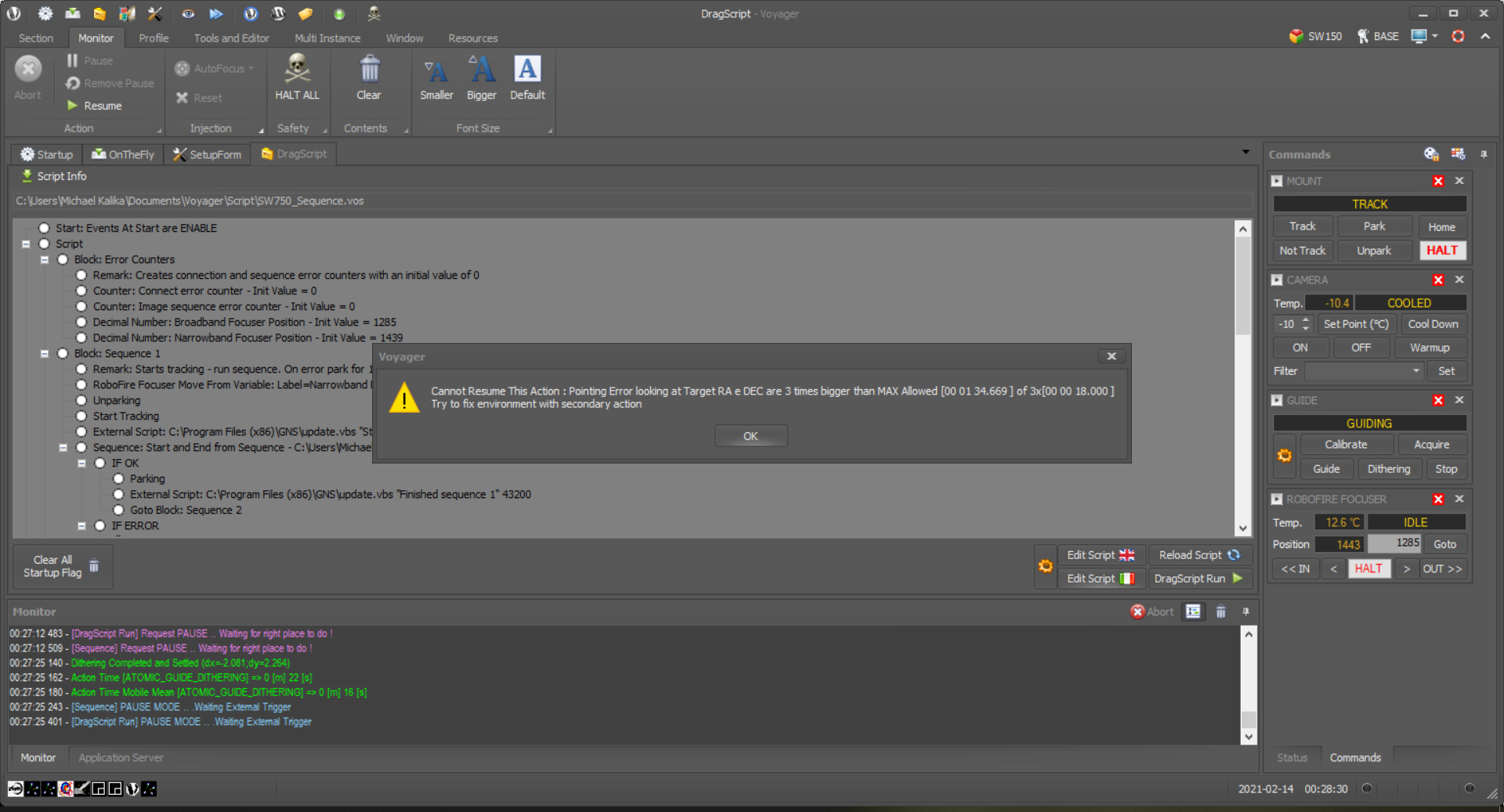

I tried for the first time to pause the sequence in DragScript and when I resumed, this is the message I got:
Can someone please help me understand what does this mean and how can I pause and resume DragScript?
Thank you!
Thank you!
The only block can be suspend in a DragScript is the Sequence Block.
This message warning you that the target is not centered well, running a precise pointing from the onthefly Section and after resume the DragScript.
Thank you! The point is that I pressed pause just for a second out of curiosity to see what happens and how can I resume. So with proper guiding I could not lose the field. My explanation then is that due to dithering I was probably a bit far from the original coordinates. To resume I need to precisely pointing and then click again on resume. Correct?
Correct
