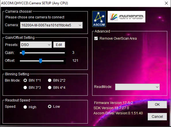

I was one among those having issues. Things have been working fine since I installed the QHY driver supplied by them. Here are my driver versions.
Screen Shot 2020-05-20 at 10.08.46 AM
Screen Shot 2020-05-20 at 10.09.07 AM
