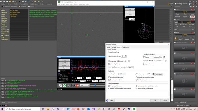

For use with voyager please not use RoboGuide but native star selection method in OnTheFly or in the Sequence configuration, and remember to select the multistar guide checkbox in PHD2 settings:

RoboGuide will never be able to use the PHD2 multi star because PHD2 chooses in that case all by itself. As I wrote just don’t use Roboguide.
To use Roboguide there is nothing to do or set except to select it in the sequence configuration. The guide will always be made by PHD2.
RoboGuide is “just” and AI automata to auto select single star for guiding in one image, when PHD2 was really bad to select star or if you using system that cannot auto select star for guiding.
