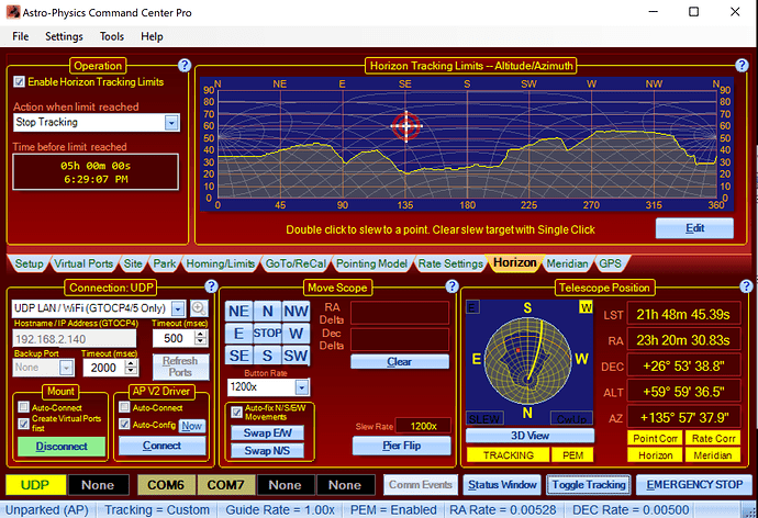

This is how APCC displays the horizon internally and how long an object has to run before a limit is reached. See top right box: Time before limit is reached.
Maybe, for AP mounts only, this information can be polled from the application (this is not an ASCOM information field though so not ASCOM compatible).
