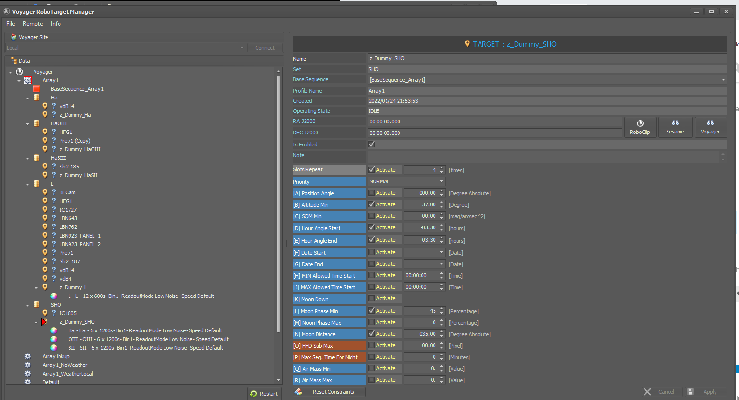

My understanding is the same as Yizhou’s. Under each set I’ve created a Dummy (called it z_Dummy for it to stay at bottom) for the constraints and shots I want for each set (for me LRGB, Ha, SHO, HaOIII, HaSII). Base Sequence is really a description for ancillary hardware settings.

This is how I am allocating targets for my main imaging scope (Array 1). I hope that when Advanced is rolled out for Array, I can easily link the RoboTarget Manager setup to Array 2:
I’m only up to RA 3hrs in my RoboClip list so quite some way to go!
Remember to disable the target dummy or will be considered in scheduling :slight_smile: or better use a set with all dummys and disable the set
