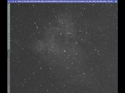

@Starship, I really like this camera. The pixel scale is good enough (with this scope, it’s 1.53"/px), that you can crop out the edges of the field if you don’t like the starshapes. Aside from the full frame sensor and good scale, the noise is very small. Here’s a comparison I made of it vs. the QHY16200A, which I had previously used.
Thanks for the video. The difference is pretty remarkable. To what do you attribute the difference: high sensitivity, low noise, or both?
Sorry, I don’t mean to take away from your thread. I can PM you, if you prefer.
No worries. I think it’s a combination of both. This sensor is a BSI sensor, which improves sensitivity, and has inherently lower read noise and dark current. You don’t have to cool it down as much as the CCDs I’ve had in the past. I’m quite happy at -10C cooling.
