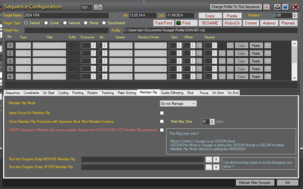

I have a Planewave L500 in an equatorial mount (with wedge). It does not need to do meridian flips. How do I turn off the meridian flip in Voyager?
Hi Gordon,
You can set this via the Sequence configuration for the sequence you are using.
Thanks. A truly minor annoyance now is all the warning messages I get about not handling meridian flip - but that’s not necessary with the Planewave mount.

Answer to you question is declare a mount like an equatorial type ! This will remove the annoying message you wrote about.
https://wiki.starkeeper.it/index.php/Mount_Setup#Management
