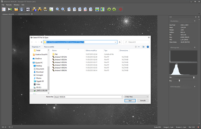

Something like this where you say name of disk and introduce the folder or not work:
immagine
Sorry but my OS is in italian
activate network service or you dont see the network
