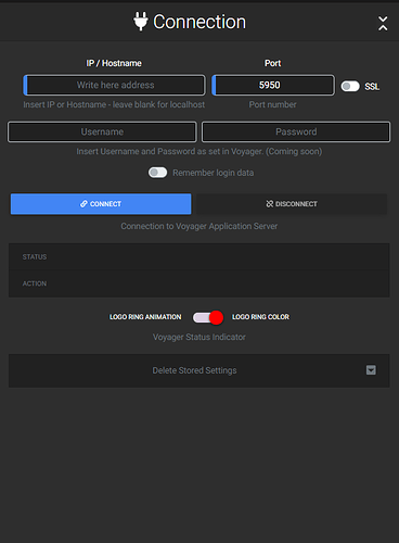

I loaded Voyager 2.2.14 last night and used it for a session without issue. However Web dashboard will not connect when leaving the IP address blank using local host (same computer as running Voyager). I was able to connect to the Web Dashboard from a separate computer on my local LAN. Thanks to you guys for the new features.

Hi Jon,
nothing has changed into IP input field since the previous version.
Please make sure you have the address input field empty, not a whitespace, you should read the placeholder, this means the field are clean. I show some screenshot
Anyway, in the next version I’ll add a function to clean the whitespace into the IP input field.
Please give mi a confirmation, thanks.

Hi Francesco,
I just checked again with a clean reboot of my computer running Voyager. I just started Voyager and then went direct to the local host web dashboard by pressing the dashboard button. The IP address field is clean. The dashboard comes up on the screen. When pressing “connect” nothing happens. If I use a different computer on my local area network, no problem, connects fine.
All the settings to allow the web dashboard are verified in the voyager setup tab.
The localhost version seemed to work fine with the previous version of Voyager.
Jon

Attached is a screen shot of my setup and what I see when connecting via local host
The configuration seems to be right, my tests works, I could check in your pc with teamviewer if you want.

Was the browser cache in dirty status, a press to F5 restart the normal connection process.
Thanks Jon to allow me to access from remote.
