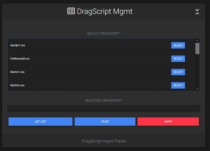

Voyager doesn’t close the application opened because cannot know at beginning if you want to shutdown all or just reconnect. Also for ASCOM driver the disconnection is managed itself when the last reference to it is closed, we cannot do anything for the ASCOM driver.
With Dragscript you can close all the process and application you want, in this way you can create your own shutdown sequence and also shutdown the PC if needed.
You can also use in DragScript external script to custom shutdown your applications:
You can do this also from the web dashboard using the dragscript list and execution panel:
After created and saved your shutdown dedicated DragScript, retrieve it from the list and execute.
