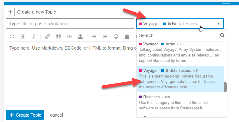

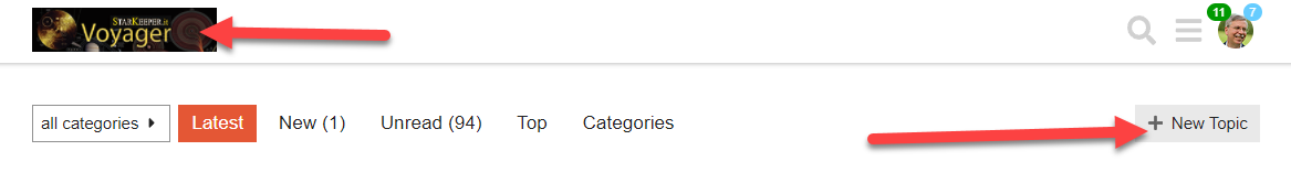

You can create new topics in the Beta Tester category - several have already been created.
Click the logo to get to the top level screen, then click New Topic:
Make sure to scroll down to the Beta Tester category - that’s the only place where it is OK to post about Voyager Advanced Beta:
