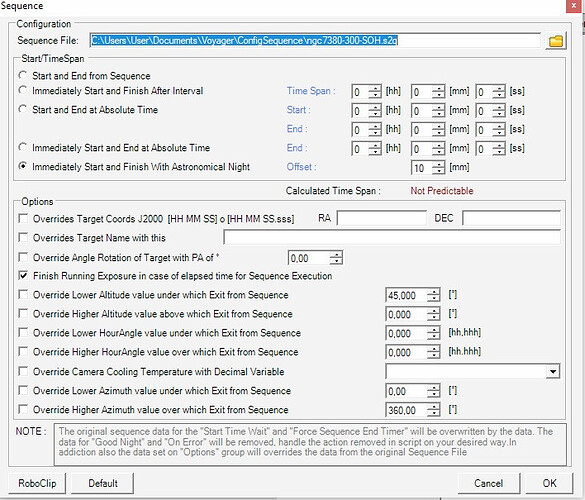

Yep i am also from 52, in drag script you can specify Nautical Night and I use that because there is no astronomical night in the summer. So for starting all items in the drag script work oke, but what do you specify for your end of the sequence. I used Absolute time and i cacluated the nautical night for each run. Due to this issue i add this calculation in my OCS see below
It would be handy to have in the sequence also the options end sequence at nautical night. How do you solve this one?
Thanks in advance chris
I normally exit when the last sequence target reaches a specific lower altitude limit (about 35 degs for my setup) but then have a catchall repeat until a specific time. At this time of year I may end up throwing the last few frames

I understood about the altitude, but i don’t understand the second part you explained. do i understand it correctly that you use also use immediately Start and end at Absolute time you specify

Take a look at the sample DragScript’s. I do much the same but have a sequence constraint to exit if <30degrees but then have a repeat until say 4:30 in DragScript for the last block. If it’s getting light at 4:30 I may then loose a few subs but heh.
