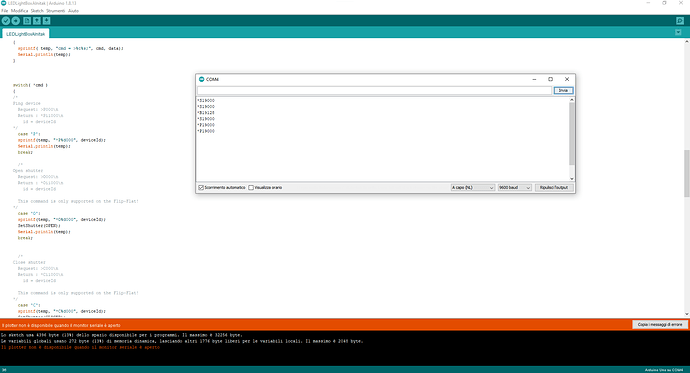

just arrived my arduino for testing.
I will test the ones in this thread, if someone else is around please send to me the link for download the project.
