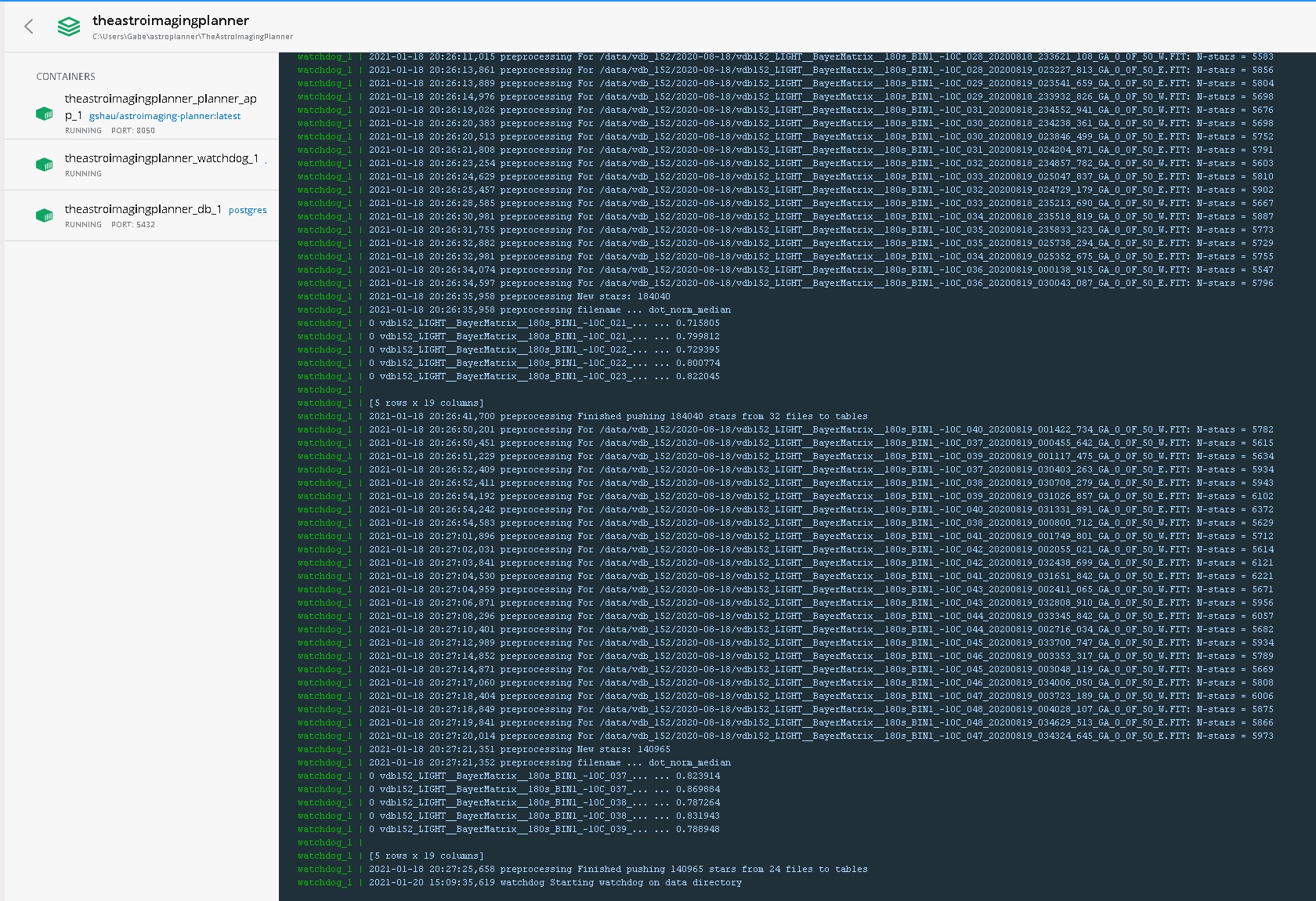

You should be able to close the command window that comes up when you run the run-docker script. You can track the activity in the main docker GUI:

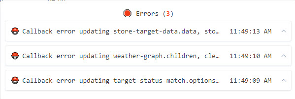

Hi
I have updated with the new version. I have a few errors. The one about the weather graph is not new but the other ones are. I have adapted the new conf files with my info
2021-01-25_11-58-00
The “Change Target Status” menu is empty And I think the button for saving the target status has disapeared.
here are the traceback
Traceback (most recent call last):
File “/app/src/app.py”, line 913, in store_data
for profile in profile_list:
TypeError: ‘NoneType’ object is not iterable
File “/app/src/app.py”, line 752, in update_target_for_status_callback
df_combined_group = df_combined[df_combined[“GROUP”].isin(profile_list)]
File “/usr/local/lib/python3.8/site-packages/pandas/core/series.py”, line 4685, in isin
result = algorithms.isin(self, values)
File “/usr/local/lib/python3.8/site-packages/pandas/core/algorithms.py”, line 417, in isin
raise TypeError(
TypeError: only list-like objects are allowed to be passed to isin(), you passed a [NoneType]
Let me know if you need additionnal information

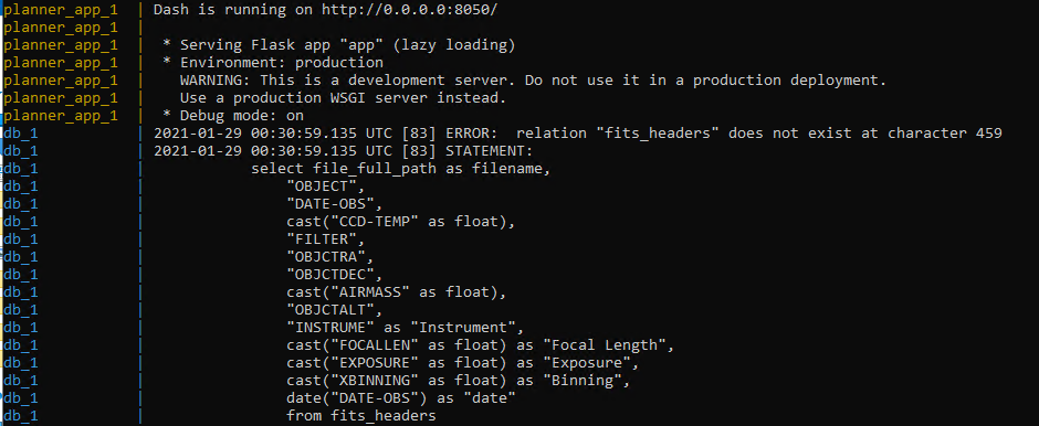

I probably have no clue what I am doing. I just installed Dock, set the path in env and fire up run-docker, and it gives me this error message, and seems stuck here:
It does seem like it’s progressing to the “watchdog” where it grabs images in the data folder (and subfolder) and seems analyzing the stars? I guess it would take a long time for a lot of data… also do I need to keep the planner open in the background all the time, or it does save the analyzed results and would only grab new images as they come in?

Thanks for the report. When profile_list is None, that indicates the Roboclip groups are not being processed correctly. What are your group names called? If you need more assistance, let me know via PM, and we can get more into details :slight_smile:
Gabe
Hi Yizhou!
Thanks for trying it out. It looks like the dash app is activated. Did you navigate to http://localhost:8050? If the fits_headers table isn’t being created, it’s likely because there are no suitable FITs files available in the path you provided. The watchdog goes through several steps, the first being a process of all the fits headers before going on to star metadata analysis. That fits header process should be relatively quick to start and you’ll see a bunch of files listed as they’re processed. The star analysis takes longer, and there’s extra verbosity there too on what it’s doing. If you see none of that, then I don’t think the watchdog has identified any files available for processing.

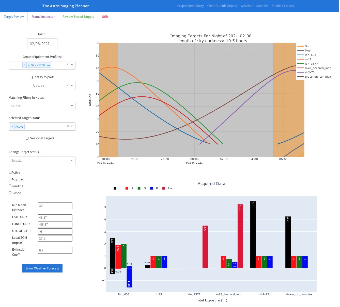

I have just released a new version with lots of new things:

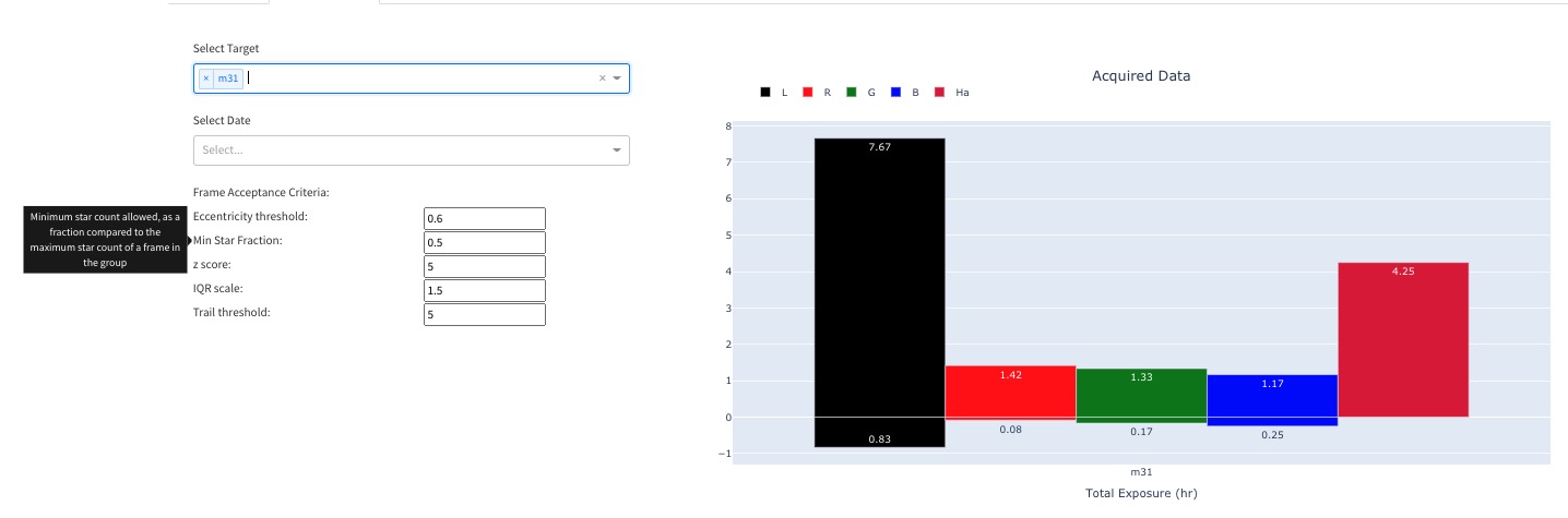

  • Automatic image grading! You can set the criteria thresholds you’d like to use, including star counts, eccentricity, etc., and the progress graphs will update accordingly. You always will have the all the data represented in the graph, but it’ll slide down with the negative portion of the graph indicating the subs that don’t pass the threshold.
  • Tooltips to help explain the image grading settings.
  • Additional progress graphs in the inspector view.
  • Date selection for inspector views.
  • Local database persistence. From this version on, you can upgrade the planner and not need to regenerate the database tables.
  • Improved status handling.
  • File skiplist buttons to clear/view the files that the watchdog has skipped due to an error.
  • General performance/stability improvements.
Also, new in this release is automatic image grading. You can specify the threshold values for some parameters like eccentricity, etc., and the progress graphs will update accordingly.
@Paul_Muller @martin This release should solve the issues you’ve been having. Please let me know via PM is you’re still having issues.

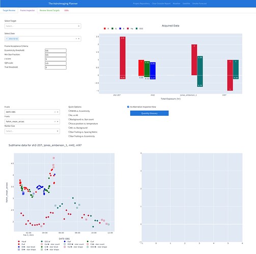

Here are some screenshots of the new version:

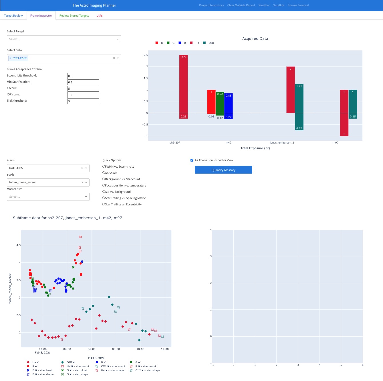

Main planner tab showing the updated acquired data graph.
New inspector view showing target progress and frame acceptance criteria.
The plot progress mimics the behavior in the main target review tab for easier reference.

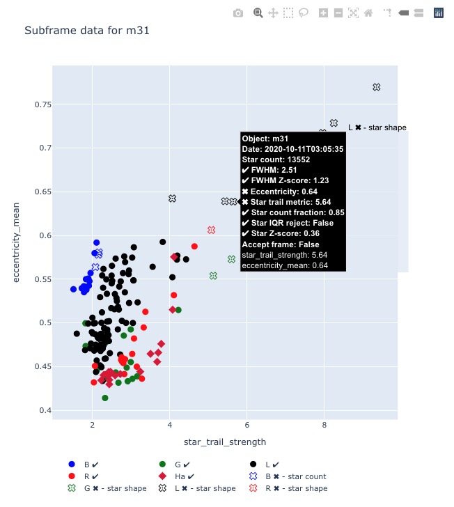

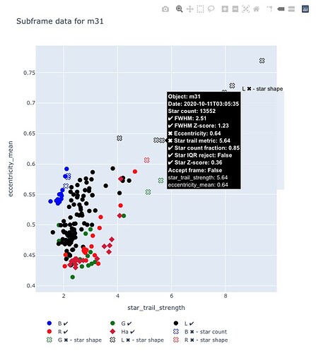

Inspector view with hover box on the scatter plot showing why this particular frame was rejected

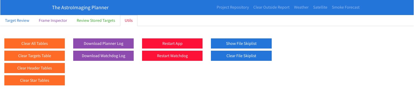

Utils section showing available options
Previous night view where only the date is selected.
Only frames from that date are shown in the bar chart and scatter plot. I like this view since you can monitor the seeing across the night. I had two systems out for this night, and you can see the correlation of the FWHM is fairly high between the two sets of measurements.
