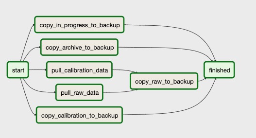

For data management, I’m also using airflow to coordinate local backups every 3 hours. Below is a view of the DAG that shows the dependencies in my archiving. I first pull all the new raw and calibration data from dropbox to my local external SSD. Then I push all that to my NAS. I should probably do another DAG that pushes things to S3 glacier or something, but haven’t gotten around to it. That would fit the 321 system of backing up data.

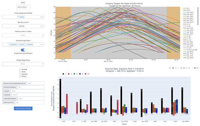

I’ve installed version 0.3.0. Everything appears to be working for me except the tab Review Stored Targets is not populating. I am using Madratter’s Roboclip file. His Roboclip groups are by object i.e. galaxy, reflection nebula, open cluster, etc. I was wondering if that is the reason the Stored Targets shows nothing. I am seeing Acquired Data in the Target Review and Frame Inspector tabs, so the Planner is reading my image files.
Any thoughts on how to get the Stored Targets to populate?
Thanks for your kind comment Brian. Would you mind sending me your roboclip db file? I can see what’s going on.
Gabe
Thank you for taking a look at this. The db file wont upload to this forum post. Here is a link to the file: [Target List - Madratter's AstroImaging ](Target List - Madratter's AstroImaging.
Brian
Thanks for the link Brian. That’s quite an extensive list. I tested that file and found the same issue. After drilling down a bit into the issue, I think it is that the groups are named by object type. I’ll think about how best to handle this, since I know the naming will vary among different users.

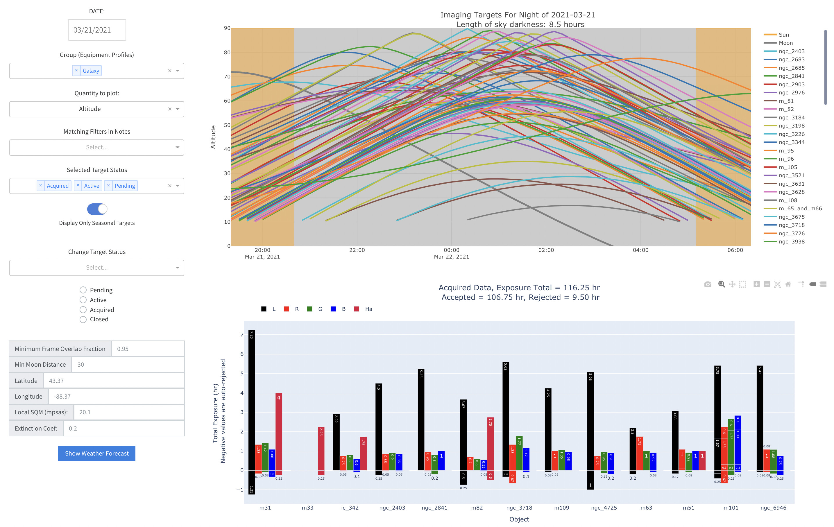

I have a working version of the planner that matches the targets in the roboclip database, and the objects stored. I tested this with the Madratter’s Roboclip db file @Brian linked to, and it works pretty well.
Internally, what this does is match the distance in degrees between the target RA/Dec coordinates and the entries stored in the FITs headers. Then, I create a metric called frame overlap fraction, which related to the distance from the target center to the frame center, divided by half the vertical field of view. Specifically, it’s: 1 - distance / (fov_y / 2)
You can specify how close the object should be compared to the target with the Minimum Frame Overlap Fraction setting on the left side.
This version is live under the dev tag. To use it, you can do the following:
  • run docker pull gshau/astroimaging-planner:dev
  • Edit the env.conf file to use the dev image rather than the latest. You need to make changes so that it reads APP_VERSION=dev (note, if you don’t see this entry in your file, you need to be working from v0.3.4.)
  • Run the app like normal with the run-app.sh or run-app.bat file
To go back to the latest version, just change APP_VERSION=latest and run again the run-app file
Let me know if you encounter any issues!

I was able to get the dev version working and the Targets Table loads now! I am still playing around with all of the pages and options, but so far, it looks good.
Is there a way to limit the decimal places displayed for total time on each filter in the Targets table? It is reading out about 14 decimal places. Two places is enough for me. :wink:
I’ve been keeping an Excel spreadsheet tracking each one of my targets. Using your AstroImaging Planner, I identified at least two different sessions I failed to log in my spreadsheet (I have more time on targets than I thought).
Once I process my data, I move all the subs to a usb hard drive. Will this mess up the Targets Table, or will that target just drop off the table?

The rounding issue will be fixed in the next dev build. Currently, there’s no adjustments made in the internal db to the paths of files if you move them. The metadata - star metrics, total exposure, etc. is still there. However, you cannot use the 9-panel inspector since it loads the data when you click on a point in the scatter graph. I can look into making the fix for tracking files moving over time.
